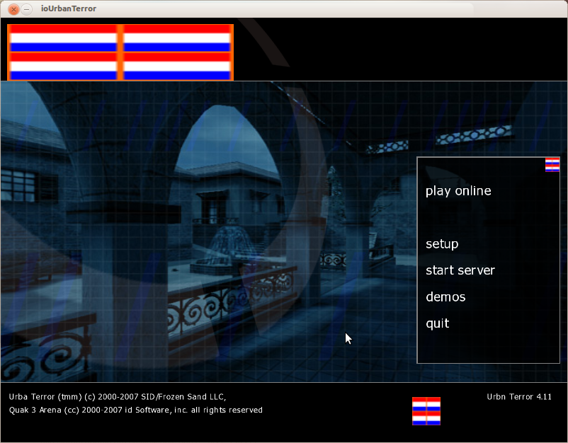

花了一天多的时间下载的压缩包,1G多,可是进入程序后是这个样子,哪个选项都进不去,这是怎么回事啊?
DELL vostro 1310
Inter Core2 T8100 2.1GHz
DDR2 667MHz 1G
NVIDIA Geforce 8400M GS 128M
DDR2 667MHz 1G

Re: UrbanTerror无法游戏,请教!
我的也是,升级到12.04后就这个样子了。
根据官网的提示估计问题出在这里了:
Could not load Curl lib (linux)
Either you don't have curl installed installed or the name of the lib is different than the game expects. You can install curl through your package manager. You can set the name of your lib by opening the Urban Terror console (shift + escape when in the main menu) and then typing: /cl_curllib .
Issues with your mouse
If you're having issues with your mouse, check to see what your /in_mouse setting is at. By default in_mouse is set to "-1", to change this via console, type:
/in_mouse (to see what the current value is)
then to change it:
/in_mouse "1" or "-1"
then for the setting to take effect:
/in_restart
Also, if your mouse 4/5/6/7/8 buttons aren't working, try binding them to keyboard strokes. Lots of mouse drivers let you do this (Logitech for example), otherwise there's other programs available that let you do this.
then to change it:
/in_restart
试过了,能用!
