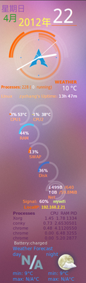

我所做的就是收集conky各种主题,选择自认为实用好看的part,截选、组合、更改和调配,达到自己满意的效果。
这里主要介绍天气获取和时钟轮(网速监测)实现的方法与过程。
##################################mark#########################################

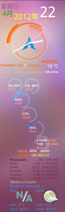

最先找到的是一段监测有线网卡的主题程序(图3),如果是台式机,只有有线网卡,用这段程序足以保证网速的正确检测,
[mw_shl_code=powershell,true]${font 文泉驿微米黑:style=Bold:size=11}下载速度: ${font Impact:size=9}${downspeed eth0} k/s ${font 文泉驿微米黑:style=Bold:size=11}上传速度:${alignr}${font Impact:size=9}${upspeed eth0} k/s
${color #88aadd}${downspeedgraph eth0 15,105 ff0000 0000ff} $alignr${color #88aadd}${upspeedgraph eth0 15,105 0000ff ff0000}
${color white}${font 文泉驿微米黑:style=Bold:size=11}下载总量 ${font Impact:size=9}${totaldown eth0} ${font 文泉驿微米黑:style=Bold:size=11}${alignr}上传总量 ${font Impact:size=9}${totalup eth0}[/mw_shl_code]
# eth0是有线网卡的接口
但本人喜欢经常用无线啊,网速那总是0,那不是废材么,肿么办,怎样才能让其自适应的判断工作网卡并正常显示网速咧?
这就得使用if语句来作出选择了,
[mw_shl_code=powershell,true]# |--WLAN0
${if_up wlan0}
${voffset 5}${color FFFFFF}${goto 125}↓${downspeed wlan0}${color FF6600}/${totaldown wlan0}
${color FFFFFF}${goto 125}↑${upspeed wlan0}${color FF6600}${color FF6600}/${totalup wlan0}
${color FF6600}${goto 125}Net
${voffset -2}${goto 55} Signal: ${color1}${wireless_link_qual wlan0}% ${font Liberation Sans:style=Bold:size=8}${color #dcff82}${wireless_essid wlan0}
#${color}${font} ${alignr}${color2}${wireless_link_bar 8,60 wlan0}${color}
${voffset 2}${goto 55} ${color FF6600} LocalIP: ${color #FFDC35}${addr wlan0}
# |--ETH0
${else}${if_up eth0}
${voffset 15}${color FFFFFF}${goto 125}↓${downspeed eth0}${color FF6600}/${totaldown eth0}
${color FFFFFF}${goto 125}↑${upspeed eth0}${color FF6600}${color FF6600}/${totalup eth0}
${voffset 4}${font}${color FF6600}${goto 105}${voffset -4}LocalIP: ${color #FFDC35}${addr eth0}${color}
# |--PPP0
${endif}${else}${if_up ppp0}
${voffset 15}${color FFFFFF}${goto 125}↓${downspeed ppp0}${color FF6600}/${totaldown ppp0}
${color FFFFFF}${goto 125}↑${upspeed ppp0}${color FF6600}${color FF6600}/${totalup ppp0}
${font}${color FF6600}${goto 32}${voffset -4}LocalIP: ${alignr}${color2}${addr ppp0}${color}
${endif}${else}${voffset 4}${color0}${font PizzaDude Bullets:size=12}4${font}${color}${goto 32}Network Unavailable${endif}${endif}[/mw_shl_code]
无线网卡接口:wlan0
如果只是显示速度,那么OK,问题解决了。可咱是个追求完美的人,再给它加一个图形窗口吧,普通的条状bar不好看,那还得继续努力才行不是{:11_1402:}
经过不懈查找,终于让我发现一种时钟型的实现方式。外号:蛋蛋conky。{:11_1365:}
这个配置需要另外加载脚本:clock_rings.lua。复制以下代码保存为clock_rings.lua
注解:在网络一段 如
name='downspeedf',
arg='wlan0',
max=1000,
中1000的单位为KB,请根据自己所在网络的实际带宽修改,否则会出现变化不明显(带宽小设置过大)或动则满速(设置太小)

个人觉得功能最强大,实现结果最漂亮的方法!嘿嘿,但是咱不告诉你,{:11_1397:}
{:2_114:}。
最后实现效果如图:
开个玩笑,好东西当然要大家一起分享啦。

附上最后的配置代码:
通用.conkyrc:
需要显示天气的在将天气代码附加到最后即可。
[mw_shl_code=bash,true]# Conky settings #

呃。。。我是新手,表示看代码压力山大啊,呵呵,能否分享一下
上面第三张图 : 111841kgzihc5997tx86xh.png [ 201.86 KiB | 被浏览 454 次 ] 的数据呀?
还有就是为什么按照您的方法,就是最后那段代码 + 天气代码 显示天气的地方显示的是输入的代码呢??
小白求教啊

1.为何我的显卡双行显示?
2.修改成一个环一个环(比如cpu占用率用环状显示)的代码是什么?
3,修改成这一块那一块,比如说我的cpu信息在右边,硬盘信息在左边的代码是什么
yq-ysy
帖子: 4653
注册时间: 2008-07-19 12:44
来自: 广西(桂)南宁(邕)
Re: 桌面美化——conky配置详解(bash shell编程)
帖子 yq-ysy » 2014-09-15 23:47
了解学习一下 写了:1.为何我的显卡双行显示?
(1)把代码前面的 goto 数值减少即可。
(2)一个环一个环,置顶帖教程有配置方法,是开罗模式。
(3)向右对齐 alignr 向左对齐 alignl
