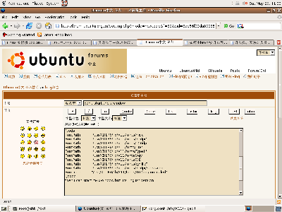

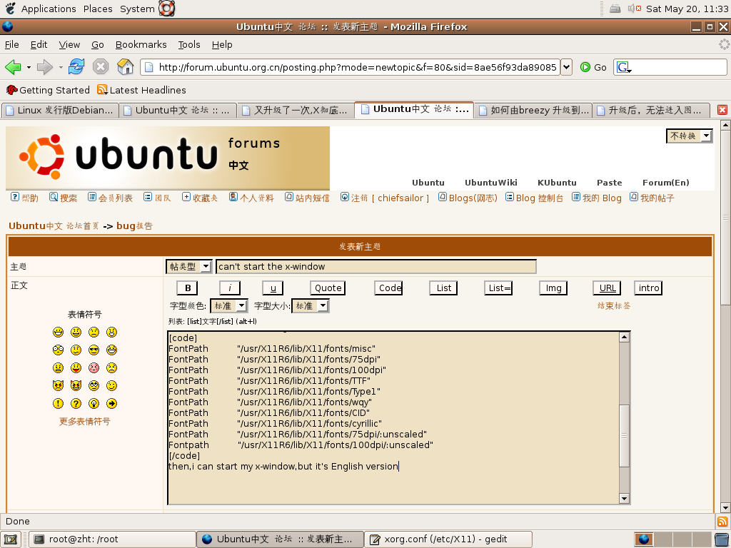

then,i can start my x-window,but it's English version
like the picture i have upload
