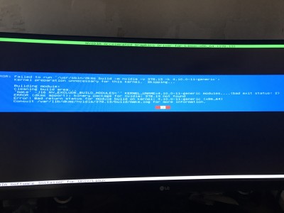

4)检查nouveau driver确保没有被加载!
$ lsmod | grep nouveau
lz是缺失了驱动的依赖kernel-devel。首先要安装kernel-devel才能继续安装驱动。不过kernel-devel是rpm的东西。
在ubuntu下,安装的不一样,打开终端,输入sudo apt-get install linux-headers-generic,安装好之后再安装驱动。
sudo apt-get install linux-source
报错the distribution-provided pre-install script failed!不必理会,继续安装;
For example:
The distribution-provided pre-install script failed!
Failed to install the kernel module through DKMS.
ERROR: Unable to find the kernel source tree for
the currently running kernel. Please make sure
you have installed the kernel source files for
your kernel and that they are properly configured;
on Red Hat Linux systems, for example, be sure you
have the 'kernel-source' or 'kernel-devel' RPM
installed. If you know the correct kernel source
files are installed, you may specify the kernel
source path with the '--kernel-source-path' command
line option.
sh NVIDIAxxx --kernel-source-path=/usr/src/kernels/x.xx.x-xxxx
其中 NVIDIAxxx 为 nvidia 驱动脚本文件, x.xx.x-xxxx 为 kernel 版本号。
sudo ./cuda_6.5.14_linux_64.run --kernel-source-path=/usr/src/linux-headers-`uname -r`/
ls /usr/src/linux-headers/$(uname -r)
ERROR: Failed to run `/usr/sbin/dkms build -m nvidia -v 304.22 -k
3.5.0-21-generic`: Error! Your kernel headers for kernel
3.5.0-21-generic cannot be found.
Please install the linux-headers-3.5.0-21-generic package,
or use the --kernelsourcedir option to tell DKMS where it's located
ERROR: Failed to install the kernel module through DKMS. No kernel module
was installed; please try installing again without DKMS, or check the
DKMS logs for more information.
ERROR: Installation has failed. Please see the file
'/var/log/nvidia-installer.log' for details. You may find
suggestions on fixing installation problems in the README available
on the Linux driver download page at www.nvidia.com.
sudo apt-get install dkms build-essential linux-headers-$(uname -r)

给NVIDIA驱动打补丁(可以使用ryzen的4.10内核与Nvidia 378.13兼容性不好导致了一个bug出现)
cd ~/Downloads
sudo sh NVIDIA-*.run -x
cd ~/Downloads/NV*13
sudo patch -p1 <<< $(curl https://gist.githubusercontent.com/tpru ... tfile1.txt)
参考文:1:https://devtalk.nvidia.com/default/topi ... rnel-4-10/

Hello everyone,
First of all I have a problem related to installing nvidia driver under ubuntu 16.04 with kernel 4.10.
sudo apt-get update && sudo apt-get upgrade && reboot
#Download Kernel 4.10 (linux-header...all linux-header...amd64 | linux-image...generic)
Wget Http://kernel.ubuntu.com/~kernel-ppa/ma ... 31_all.deb Http://kernel.ubuntu.com/~kernel-ppa/ma ... _amd64.deb Http://kernel.ubuntu.com/~kernel-ppa/ma ... _amd64.deb
#Install kernel
Sudo dpkg -i linux - *. Deb
Reboot
In a TTY console:
Sudo service lightdm stop
Sudo ./Nvidia-....run
reboot
/var/lib/dkms/nvidia/378.13/build/make.log
DKMS make.log for nvidia-378.13 for kernel 4.10.0-041000rc8-generic (x86_64)
mardi 21 février 2017, 18:08:13 (UTC+0100)
make "CC=cc" KBUILD_VERBOSE= -C /lib/modules/4.10.0-041000rc8-generic/build M=/var/lib/dkms/nvidia/378.13/build ARCH=x86_64 NV_KERNEL_SOURCES=/lib/modules/4.10.0-041000rc8-generic/build NV_KERNEL_OUTPUT=/lib/modules/4.10.0-041000rc8-generic/build NV_KERNEL_MODULES="nvidia nvidia-uvm nvidia-modeset nvidia-drm" INSTALL_MOD_DIR=kernel/drivers/video modules
make[1]*: on entre dans le répertoire «*/usr/src/linux-headers-4.10.0-041000rc8-generic*»
SYMLINK /var/lib/dkms/nvidia/378.13/build/nvidia/nv-kernel.o
SYMLINK /var/lib/dkms/nvidia/378.13/build/nvidia-modeset/nv-modeset-kernel.o
CONFTEST: INIT_WORK
CONFTEST: remap_pfn_range
CONFTEST: follow_pfn
CONFTEST: vmap
CONFTEST: set_pages_uc
CONFTEST: set_memory_uc
CONFTEST: change_page_attr
CONFTEST: set_memory_array_uc
CONFTEST: pci_get_class
CONFTEST: pci_choose_state
CONFTEST: vm_insert_page
CONFTEST: acpi_device_id
CONFTEST: acquire_console_sem
CONFTEST: console_lock
CONFTEST: kmem_cache_create
CONFTEST: on_each_cpu
CONFTEST: smp_call_function
CONFTEST: acpi_evaluate_integer
CONFTEST: ioremap_cache
CONFTEST: ioremap_wc
CONFTEST: acpi_walk_namespace
CONFTEST: pci_dma_mapping_error
CONFTEST: pci_domain_nr
CONFTEST: sg_alloc_table
CONFTEST: sg_init_table
CONFTEST: pci_get_domain_bus_and_slot
CONFTEST: get_num_physpages
CONFTEST: efi_enabled
CONFTEST: proc_create_data
CONFTEST: pde_data
CONFTEST: proc_remove
CONFTEST: pm_vt_switch_required
CONFTEST: drm_driver_has_set_busid
CONFTEST: drm_driver_has_gem_prime_res_obj
CONFTEST: xen_ioemu_inject_msi
CONFTEST: phys_to_dma
CONFTEST: get_dma_ops
CONFTEST: write_cr4
CONFTEST: of_parse_phandle
CONFTEST: for_each_online_node
CONFTEST: node_end_pfn
CONFTEST: pci_bus_address
CONFTEST: pci_stop_and_remove_bus_device
CONFTEST: pci_remove_bus_device
CONFTEST: request_threaded_irq
CONFTEST: remap_page_range
CONFTEST: address_space_init_once
CONFTEST: kbasename
CONFTEST: fatal_signal_pending
CONFTEST: list_cut_position
CONFTEST: vzalloc
CONFTEST: wait_on_bit_lock_argument_count
CONFTEST: bitmap_clear
CONFTEST: usleep_range
CONFTEST: radix_tree_empty
CONFTEST: drm_dev_unref
CONFTEST: drm_reinit_primary_mode_group
CONFTEST: drm_atomic_set_mode_for_crtc
CONFTEST: drm_atomic_clean_old_fb
CONFTEST: get_user_pages_remote
CONFTEST: drm_gem_object_lookup
CONFTEST: drm_atomic_state_free
CONFTEST: i2c_adapter
CONFTEST: irq_handler_t
CONFTEST: pm_message_t
CONFTEST: acpi_device_ops
CONFTEST: acpi_op_remove
CONFTEST: outer_flush_all
CONFTEST: proc_dir_entry
CONFTEST: scatterlist
CONFTEST: sg_table
CONFTEST: file_operations
CONFTEST: vm_operations_struct
CONFTEST: atomic_long_type
CONFTEST: pci_save_state
CONFTEST: file_inode
CONFTEST: task_struct
CONFTEST: kuid_t
CONFTEST: dma_ops
CONFTEST: dma_map_ops
CONFTEST: noncoherent_swiotlb_dma_ops
CONFTEST: vm_fault_present
CONFTEST: fault_flags
CONFTEST: atomic64_type
CONFTEST: backing_dev_info
CONFTEST: kernel_write
CONFTEST: strnstr
CONFTEST: iterate_dir
CONFTEST: kstrtoull
CONFTEST: mm_context_t
CONFTEST: vm_fault_has_address
CONFTEST: vm_ops_fault_removed_vma_arg
CONFTEST: drm_bus_present
CONFTEST: drm_bus_has_bus_type
CONFTEST: drm_bus_has_get_irq
CONFTEST: drm_bus_has_get_name
CONFTEST: drm_driver_has_legacy_dev_list
CONFTEST: drm_crtc_state_has_connectors_changed
CONFTEST: drm_init_functions_have_name_arg
CONFTEST: drm_mode_connector_list_update_has_merge_type_bits_arg
CONFTEST: drm_helper_mode_fill_fb_struct_has_const_mode_cmd_arg
CONFTEST: drm_master_drop_has_from_release_arg
CONFTEST: drm_mode_config_funcs_has_atomic_state_alloc
CONFTEST: dom0_kernel_present
CONFTEST: nvidia_vgpu_kvm_build
CONFTEST: drm_available
CONFTEST: nvidia_grid_build
CONFTEST: drm_atomic_available
CONFTEST: drm_atomic_modeset_nonblocking_commit_available
CC [M] /var/lib/dkms/nvidia/378.13/build/nvidia/nv-frontend.o
CC [M] /var/lib/dkms/nvidia/378.13/build/nvidia/nv-instance.o
CC [M] /var/lib/dkms/nvidia/378.13/build/nvidia/nv.o
CC [M] /var/lib/dkms/nvidia/378.13/build/nvidia/nv-acpi.o
CC [M] /var/lib/dkms/nvidia/378.13/build/nvidia/nv-chrdev.o
CC [M] /var/lib/dkms/nvidia/378.13/build/nvidia/nv-gvi.o
CC [M] /var/lib/dkms/nvidia/378.13/build/nvidia/nv-dma.o
CC [M] /var/lib/dkms/nvidia/378.13/build/nvidia/nv-cray.o
CC [M] /var/lib/dkms/nvidia/378.13/build/nvidia/nv-i2c.o
CC [M] /var/lib/dkms/nvidia/378.13/build/nvidia/nv-mempool.o
CC [M] /var/lib/dkms/nvidia/378.13/build/nvidia/nv-mmap.o
CC [M] /var/lib/dkms/nvidia/378.13/build/nvidia/nv-p2p.o
CC [M] /var/lib/dkms/nvidia/378.13/build/nvidia/nv-pat.o
CC [M] /var/lib/dkms/nvidia/378.13/build/nvidia/nv-procfs.o
CC [M] /var/lib/dkms/nvidia/378.13/build/nvidia/nv-usermap.o
CC [M] /var/lib/dkms/nvidia/378.13/build/nvidia/nv-vm.o
CC [M] /var/lib/dkms/nvidia/378.13/build/nvidia/nv-vtophys.o
/var/lib/dkms/nvidia/378.13/build/nvidia/nv-pat.c: In function ‘nvidia_cpu_callback’:
/var/lib/dkms/nvidia/378.13/build/nvidia/nv-pat.c:213:14: error: ‘CPU_DOWN_FAILED’ undeclared (first use in this function)
case CPU_DOWN_FAILED:
/var/lib/dkms/nvidia/378.13/build/nvidia/nv-pat.c:213:14: note: each undeclared identifier is reported only once for each function it appears in
/var/lib/dkms/nvidia/378.13/build/nvidia/nv-pat.c:220:14: error: ‘CPU_DOWN_PREPARE’ undeclared (first use in this function)
case CPU_DOWN_PREPARE:
In file included from /var/lib/dkms/nvidia/378.13/build/nvidia/nv-pat.c:15:0:
/var/lib/dkms/nvidia/378.13/build/nvidia/nv-pat.c: In function ‘nv_init_pat_support’:
/var/lib/dkms/nvidia/378.13/build/common/inc/nv-linux.h:391:34: error: implicit declaration of function ‘register_cpu_notifier’ [-Werror=implicit-function-declaration]
#define register_hotcpu_notifier register_cpu_notifier
/var/lib/dkms/nvidia/378.13/build/nvidia/nv-pat.c:258:17: note: in expansion of macro ‘register_hotcpu_notifier’
if (register_hotcpu_notifier(&nv_hotcpu_nfb) != 0)
/var/lib/dkms/nvidia/378.13/build/nvidia/nv-pat.c: In function ‘nv_teardown_pat_support’:
/var/lib/dkms/nvidia/378.13/build/common/inc/nv-linux.h:388:36: error: implicit declaration of function ‘unregister_cpu_notifier’ [-Werror=implicit-function-declaration]
#define unregister_hotcpu_notifier unregister_cpu_notifier
/var/lib/dkms/nvidia/378.13/build/nvidia/nv-pat.c:283:9: note: in expansion of macro ‘unregister_hotcpu_notifier’
unregister_hotcpu_notifier(&nv_hotcpu_nfb);
cc1: some warnings being treated as errors
scripts/Makefile.build:294*: la recette pour la cible «*/var/lib/dkms/nvidia/378.13/build/nvidia/nv-pat.o*» a échouée
make[2]: *** [/var/lib/dkms/nvidia/378.13/build/nvidia/nv-pat.o] Erreur 1
make[2]: *** Attente des tâches non terminées....
Makefile:1496*: la recette pour la cible «*_module_/var/lib/dkms/nvidia/378.13/build*» a échouée
make[1]: *** [_module_/var/lib/dkms/nvidia/378.13/build] Erreur 2
make[1]*: on quitte le répertoire «*/usr/src/linux-headers-4.10.0-041000rc8-generic*»
Makefile:81*: la recette pour la cible «*modules*» a échouée
make: *** [modules] Erreur 2
Posted 02/21/2017 08:14 PM
towo
If you would use the search function, you would see, that it's well known and a crude patch is available.

-> Installing DKMS kernel module:
ERROR: Failed to run `/usr/sbin/dkms build -m nvidia -v 378.13 -k 4.10.0-11-generic`:
Kernel preparation unnecessary for this kernel. Skipping...
Building module:
cleaning build area...
'make' -j16 NV_EXCLUDE_BUILD_MODULES='' KERNEL_UNAME=4.10.0-11-generic modules....(bad exit status: 2)
ERROR (dkms apport): binary package for nvidia: 378.13 not found
Error! Bad return status for module build on kernel: 4.10.0-11-generic (x86_64)
Consult /var/lib/dkms/nvidia/378.13/build/make.log for more information.
-> error.
ERROR: Failed to install the kernel module through DKMS. No kernel module was installed; please try installing again without DKMS, or check the DKMS logs for more information.
ERROR: Installation has failed. Please see the file '/var/log/nvidia-installer.log' for details. You may find suggestions on fixing installation problems in the README available on the Linux driver download page at www.nvidia.com.
cd ~/Downloads

hello,
i successfull patching !
Infos Patch:
Patch for driver: nvidia-378.09
GIT: https://gist.github.com/tpruzina
Folder: (Very important)
~/Downloads/NVIDIA-Linux-x86_64-378.09/ <= Folder when your Extract (by command)
~/Downloads/NVIDIA-Linux-x86_64-378.09.run
~/Downloads/nvidia-378.09-kernel-4.10-rc4.patch
Downloads + Permission: (French)
cd ~/Downloads
wget https://gist.githubusercontent.com/tpru ... -rc4.patch
wget http://fr.download.nvidia.com/XFree86/L ... 378.09.run
sudo chmod +x NVIDIA-Linux-x86_64-378.09.run
Extracted Run: (*.run -x)
./NVIDIA-*.run -x
Apply patch
patch -p0 < ./nvidia-*.patch
My Logs:
patching file NVIDIA-Linux-x86_64-378.09/kernel/common/inc/nv-linux.h
patching file NVIDIA-Linux-x86_64-378.09/kernel/nvidia/nv-p2p.c
patching file NVIDIA-Linux-x86_64-378.09/kernel/nvidia-drm/nvidia-drm-fence.c
patching file NVIDIA-Linux-x86_64-378.09/kernel/nvidia-drm/nvidia-drm-gem.c
patching file NVIDIA-Linux-x86_64-378.09/kernel/nvidia-drm/nvidia-drm-gem.h
patching file NVIDIA-Linux-x86_64-378.09/kernel/nvidia-drm/nvidia-drm-modeset.c
patching file NVIDIA-Linux-x86_64-378.09/kernel/nvidia-drm/nvidia-drm-priv.h
patching file NVIDIA-Linux-x86_64-378.09/kernel/nvidia-uvm/uvm8_test.c
Installed: Press CTRl+ALT+F3 (or F4)
Boot on kernel 4.10 (good version to patch Ex: nvidia-378.09-kernel-4.10-rc4.patch is kernel 4.10 RC4)
sudo service lightdm/gdm stop
sudo ./nvidia-installer
sudo servcice lightdm/gdm start
reboot

said:If you would use the search function, you would see, that it's well known and a crude patch is available.
ubuntu have a proper patch
https://pkgs.rpmfusion.org/cgit/nonfree ... 4.10.patch

Hello,
I would like to point out that only the Mate interface works with this driver.
Cinnamon, unity and xfce plant

Hello,
for apply patch.
Download pilote (permission + extraction)
wget http://fr.download.nvidia.com/XFree86/L ... 375.39.run
sudo chmod +x ./NVIDIA-Linux-x86_64-375.39.run
./NVIDIA-Linux-x86_64-375.39.run -x
Download Patch
cd ./NVIDIA-Linux-x86_64-375.39
wget https://pkgs.rpmfusion.org/cgit/nonfree ... 4.10.patch
Apply patch:
patch -p1 < kernel_4.10.patch
Installation
TTY (CTRL+ALT+F4)
./NVIDIA-Linux-x86_64-375.39/nvidia-install
sudo service lightdm/gdm start
reboot
LOG:
m
arc:~/Bureau/NVIDIA-Linux-x86_64-375.39$ patch -p1 < kernel_4.10.patch
patching file kernel/common/inc/nv-mm.h
patching file kernel/nvidia-drm/nvidia-drm-fence.c
patching file kernel/nvidia-drm/nvidia-drm-gem.h
patching file kernel/nvidia-drm/nvidia-drm-priv.h
patching file kernel/nvidia/nv-pat.c
