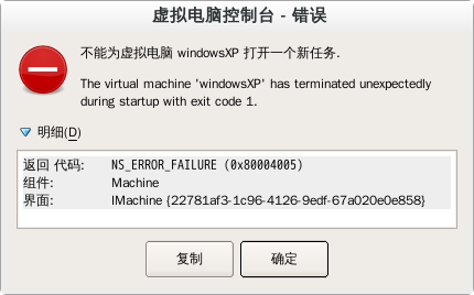

安装virtualbox extension-pack
[realrealjerry@realrealjerry ~]$ sudo '/home/realrealjerry/下载/VirtualBox-4.2.4-81684-Linux_amd64.run'
[sudo] password for realrealjerry:
Verifying archive integrity... All good.
Uncompressing VirtualBox for Linux installation............
VirtualBox Version 4.2.4 r81684 (2012-10-26T18:17:03Z) installer
Unable to determine your Linux distribution
You appear to have a version of VirtualBox on your system which was installed
from a different source or using a different type of installer (or a damaged
installation of VirtualBox). We strongly recommend that you remove it before
installing this version of VirtualBox.
Do you wish to continue anyway? [yes or no]
yes
If you are upgrading from VirtualBox 1.5 or older and if some of your virtual
machines have saved states, then the saved state information will be lost
after the upgrade and will have to be discarded. If you do not want this then
you can cancel the upgrade now.
Do you wish to continue? [yes or no]
yes
Removing previous installation of VirtualBox from /usr/lib/virtualbox
Installing VirtualBox to /opt/VirtualBox
Python found: python, installing bindings...
File "vboxapisetup.py", line 21
print "Cleaning COM cache at",comCache1,"and",comCache2
SyntaxError: invalid syntax
Building the VirtualBox kernel modules
Failed to load the kernel module.
VirtualBox has been installed successfully, but the kernel module could not
be built. When you have fixed the problems preventing this, execute
/etc/init.d/vboxdrv setup
as administrator to build it.
You will find useful information about using VirtualBox in the user manual
/opt/VirtualBox/UserManual.pdf
and in the user FAQ
http://www.virtualbox.org/wiki/User_FAQ
We hope that you enjoy using VirtualBox.
随后[realrealjerry@realrealjerry ~]$ sudo /etc/init.d/vboxdrv setup
sudo:/etc/init.d/vboxdrv:找不到命令
启动virtualbox里虚拟机时如图
求解决方案

这时候应该用modprobe -l |grep vbox看看模块编译好了没有的。 :em01 :em01 :em01

YeLee 写了:这时候应该用modprobe -l |grep vbox看看模块编译好了没有的。 :em01 :em01 :em01
[realrealjerry@realrealjerry ~]$ sudo modprobe -l |grep vbox
modprobe: invalid option -- 'l'
肿么办?

晕,都忘记arch换kmod了……那你看看内核的模块目录,看看那几个vbox的模块编译完了没有吧。 :em20 :em20 :em20

YeLee 写了:晕,都忘记arch换kmod了……那你看看内核的模块目录,看看那几个vbox的模块编译完了没有吧。 :em20 :em20 :em20
谢谢 搞定之~
