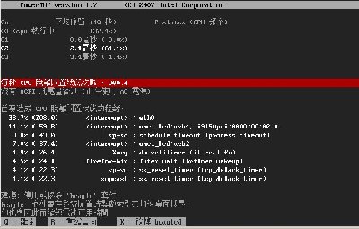

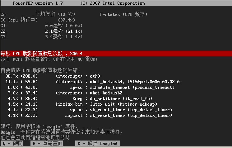

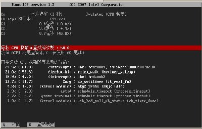

帖子 windwiny » 2007-09-30 23:06
beagle 是桌面搜索控件deskbar 的 扩展
不过开着它的时候笔记本的电池能用的时间少了很多,,
用powertop 来查看,都 建议是 砍掉它 :D
--运行的时候每秒退出闲置状态300多次,砍掉它之后几乎少了六分之五

.....更让人忍无可忍的是
OO,偶的神,为什么是这样?

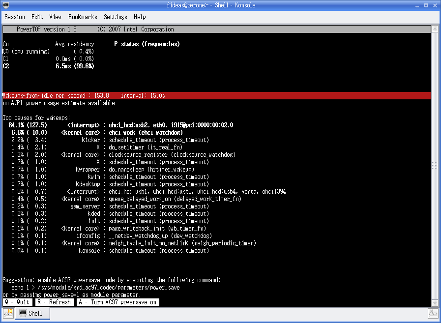

fideas@zerone ~ $ eix powertop
* sys-power/powertop
     Available versions:  1.7 1.8 {unicode}
     Homepage:            http://www.linuxpowertop.org/
     Description:         tool that helps you find what software is using the most power
     PowerTOP version 1.8       (C) 2007 Intel Corporation
Cn                Avg residency       P-states (frequencies)
C0 (cpu running)        ( 8.8%)
C1                0.0ms ( 0.0%)
C2                2.8ms (91.2%)
Wakeups-from-idle per second : 329.2    interval: 10.0s
no ACPI power usage estimate available
No detailed statistics available; please enable the CONFIG_TIMER_STATS kernel option
This option is located in the Kernel Debugging section of menuconfig
(which is CONFIG_DEBUG_KERNEL=y in the config file)
Note: this is only available in 2.6.21 and later kernels
Suggestion: Enable the CONFIG_SND_AC97_POWER_SAVE kernel configuration option.
This option will automatically power down your sound codec when not in use,
and can save approximately half a Watt of power.
 Q - Quit   R - Refresh
NND,什么破玩意,居然还要内核调试功能支持.
